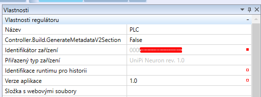

@niklas I have checked your project and I can see a irregularity:
Attached controler says "Unipi Neuron rev. 1.0" (sorry for the czech)
Typically the typy of the Attached controller contains the whole name, such as "UniPi Neuron L503 rev. 1.0". How did you attach your PLC and what model do you have?
I was able to upload and start the solution on Neuron L503.
