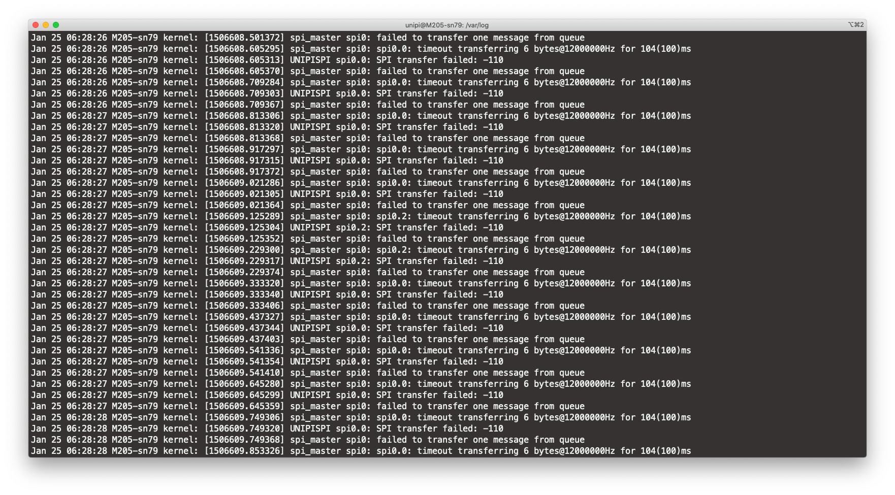

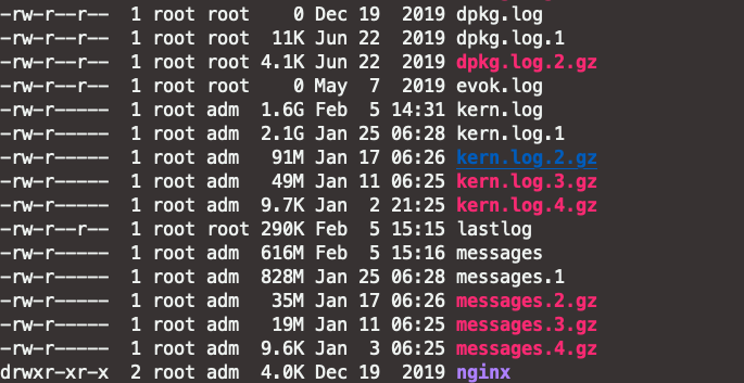

Hello, I got exactly the same problem on 2 Axon M205 controllers. How can I make sure it doesnt happen anymore ?!
