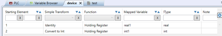

      I'm using Mervis RT, setting up a modbustcp slave (also called server). When I add a variable of type real and choose "Identity" as conversion method I get one Int on the bus instead of two. Is this a known issue or am I missing some setup?

          thats what I'm, doing. Just having the real works fine, adding the int breaks the real.

            the real value is 32bits long, that means it will take two registers, in your example registers 1 and 2. By adding register 2 with variable "int1" you have inadvertently overwrite the half of the previous register. To avoid that, set the starting element of the "int1" to 3.

              Ah, thanks! I just clicked "add variable" and didn't realise I can / have to actually edit the offset afterwards. Might be worth a feature request to change the gui to automatically check the previous value and adjust the starting element accordingly.
