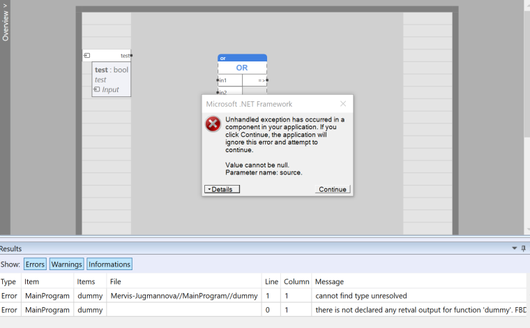

      Hi, when I create function and create some inputs and outputs it gives me an error:
      Error MainProgram testFunction 0 1 there is not declared any retval output for function 'thermometer'. FBD functions have to have retval explicitly declared
      Error cannot find type unresolved
      I don't know what to do. How to build it. There are no other options what I can setup.
      Other issue is when I delete something from this function it is ok, but when I delete other variable I have this error:
      Value cannot be null.
      Parameter name:source.

              Both issues can be seen on the pictures. One in results window and other in popup. Send it to email?
