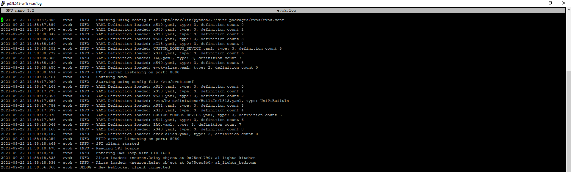

          here ist my evok.log with debug=on. Evertything seems fine, but it still won't work. I only see Analog Input & Output from 1.01.

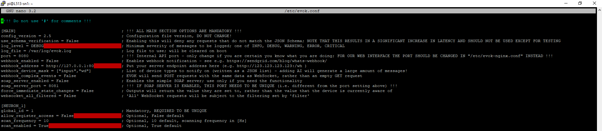

          I also made a snapshot from my evok.conf
