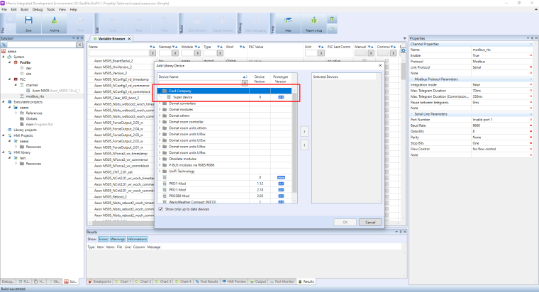

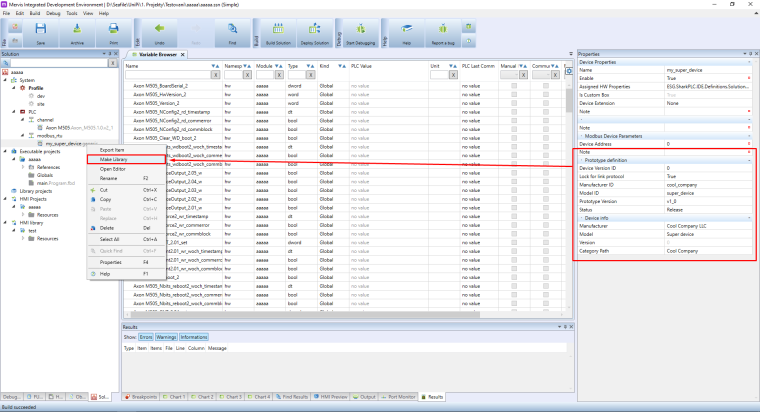

        Hello @ayone0518,
        if you want to share this device between projects, you can create a library device.
        Fill the basic information about the device and then right click on it and select "Make Library":
        The device will become a Library Device and you can add it will show up in the list of Library devices:

          @martin-kudláček tanks Martin, that might help me out.
          But I do not find 'Make Library' on device which I made.0_1578294732406_capture1.PNG
