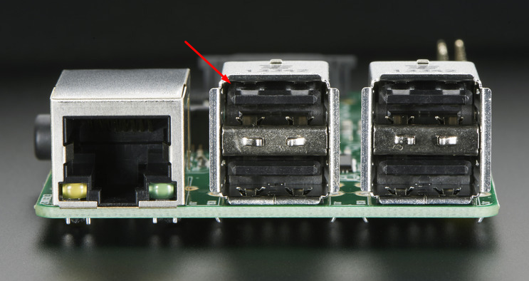

Hi @dickesc,
did you connect the converter to the correct USB. This is the USB1:
Hi
Yes, i have it connected to this port.
And i have tried all the other ports too. -
