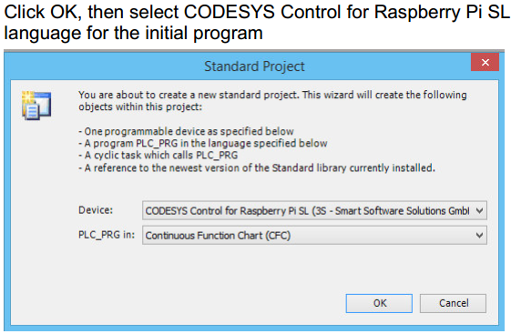

      From the Support Download Center (https://files.unipi.technology/s/public?path=%2FSoftware%2FCODESYS) I followed the document Product_datasheet_UniPi_Neuron_for_CODESYS_en.pdf

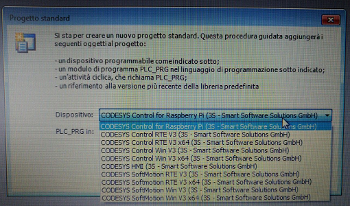

      But I face an issue. From page 10 is clearly explained how to start a new project but I'm not able to select CODESYS Control for Raspberry Pi SL but on CODESYS Control for Raspberry Pi
      0_1516630304965_upload-1861423f-c331-4a57-8509-77813c4aac69
      I think that there is something wrong with the installation CODESYS Control for Raspberry Pi SL package.
      Could someone help me, please?
      Thanks a lot.

        mikeardy @mikeardy last edited by
        @mikeardy
        I get this dialog box:
