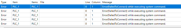

              Regarding the RT: I can upload it and IDE says "Capabilities parsing succeeded". But if I follow the manual and I want to reboot it fails several times. Only after a minute I get a successful (warm) reboot. 0_1499434357754_upload-1c4d023d-6c5a-47b7-b5b4-ce5bc42242e7
              It is the inital setup of this unipi. I completely followed the instructions but relays are always in red.

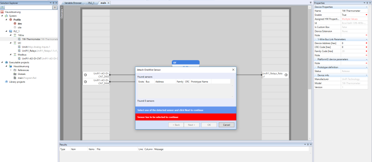

              Maybe there is a general fault in the configuration - I also have problems to detect the 1W temperature sensor from your shop. Comissioning mode >> Asign one wire sensors >> Found 0 sensors
              0_1499434804254_upload-14575e06-c079-4d70-9e79-fe384ae0049b
              Edit: Think I found the problem: I have several relay extension boards connected. I set the first board on address x32 - same like the unipi on-board relays. With the extension boards being disconnected the on-board relay works.
              I actually thought the addresses printed on the extension boards (x32-x39) were free and one could add max. 8 extension boards? But if x32 is already reserved for unipi only 7 can be added. Am I wrong?
