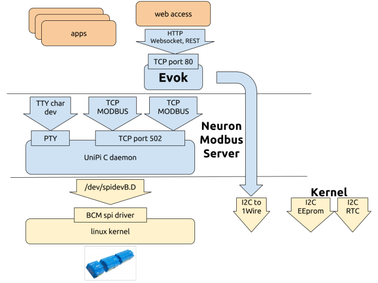

                @cvdd Technically yes, because there is one more layer (Evok) that is between your application and the HW. The difference is that Modbus has to be polled and websocktets automatically broadcasts all changes to the connected clients. So it is up to you how often you want to pull for the changes (either from your app or from Evok).
                Modbus is supported in Evok but only as a Client for the Modbus server that provides access to the IOs.
                C 1 Reply Last reply Reply Quote 0
                  cvdd @tomas_hora last edited by
                  @tomas_hora Thank you for the helpful illustration. So Modbus would be the faster choice I see. Looking through the code, Evok uses https://github.com/UniPiTechnology/neuron_tcp_modbus_overlay when installed on Neuron to host a Modbus server. Does this mean an application can't directly connect to the underlying (middle layer in the graphic) Modbus server and always has to go through Evok which itself is a Modbus client but also hosts a server to channel through requests? And why is this only on Neuron and not on default UniPi with Raspberry Pi?

                    @cvdd Of course it can, you can install only the tcp_modbus_server and use it as interface to the IOs. Evok only provides adtitional HTTP services (REST, websocket) including 1Wire.
                    The first generation UniPi uses directly GPIOs of the RPi so we build evok that it directly uses the GPIOs. But the Neuro uses the SPI as shown in the illustration so we wrote a C application to handle that.
