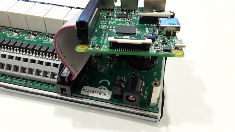

            Hello, yep the one cable is everything you need. I will post a photo tomorrow that shows how it should be connected...
            Update: See the picture, it should be connected like that. 0_1476077237312_20161010_071735.jpg

              that's exactly as i connected the cable. That seem's to be ok, as everything else
              (setting/resetting inputs and outputs) does work if i connected the power to
              the pi over the mini-USB port.
