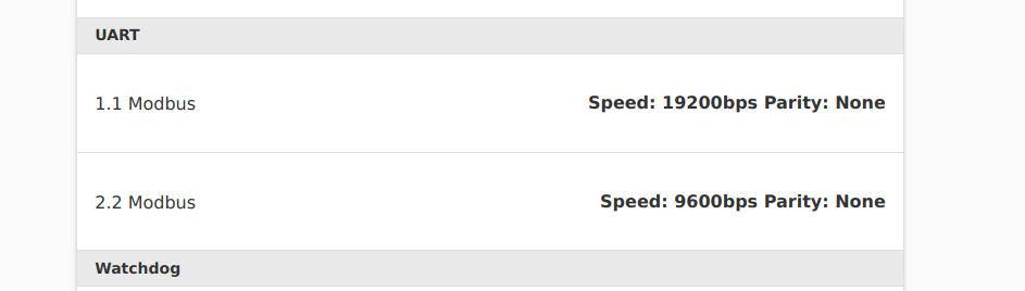

      And made the UART settings over the Evok webfrontend:
      I think, I put also the DIP switches on the xG18 to the right positions, witch are 011001 (Adress. 6; 19200bps;N)

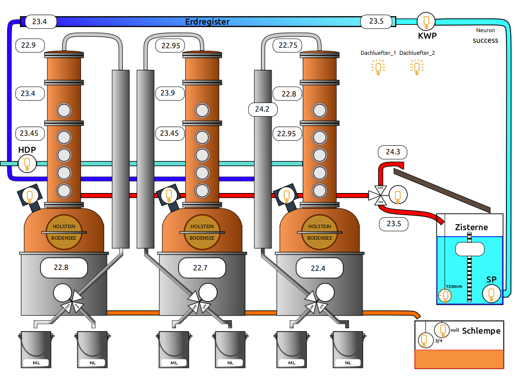

          I would like to ask you if adding the ID's of the 1 Wire temperature sensors to evok.conf has any performance advantages.
          I have been trying to work on my distillery control for some time now. I have 18 pc. DS18B20 sensors on the 1 Wire bus. The update time of the sensors is sometimes not fast enough or not reliable. With a script I do a reset of the 1Wire bus every 2 minutes.

              The xG18 extension is connected. The RS485 bus also A-A and B-B. I made all settings via the DIP switches and configured the evok.conf. (as already described above ). Unfortunately I have no connection and the rx tx LED's are not flashing. Do I still have to configure the Modbus on the unipi?
              Greetings Stefan
                martin_triska administrators last edited by
                Hello @Stoeffel,
                please try to uncomment following lines in the evok.conf within the xG18 section:
                • allow_register_access
                • scan_frequency
                • scan_enabled
                In case of no success, you can try to "hardcode" the serial line parameters (baud rate, parity, stop_bits) in the config file (by uncommenting appropriate lines).
