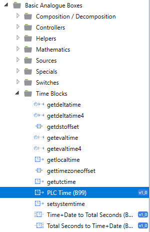

          Hi Martin, ok , i tried it, but my output is local time or timezone time, not a running time:0_1580196674716_5955e71e-edf9-40e2-ae89-ea19768428d2-image.png
          I think that what i needed is a function getevaltime: 0_1580197596174_41a486f9-2814-4dda-8d07-c12e80f50a8e-image.png
            Martin Kudláček @jaros last edited by
            Sorry @jaros for the mystification. The blocks for PLC runtime are indeed called ''getevaltime" and "getevaltime4", depending on which data type you need.
