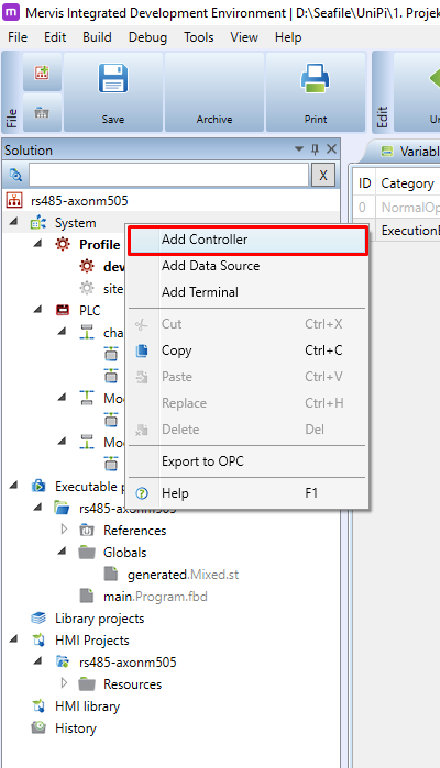

          Hi @_andi_ ,
          this is possible. Right click on the "System" in the Solution tab on the left panel and in the context menu click on the "Add controller".
          Then proceed with attaching controller as usual and setting the PLC task to the same program. When deploying the solution, you can select to which PLCs you want to deploy the solution. Select all of them.
