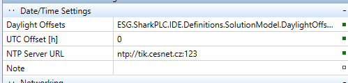

      Despite having UTC offset set to 0 in the PLC properties, and the time being set correctly in UTC:-
      root@L203-sn218:~# date
      Mon 14 Jan 19:23:22 UTC 2019
      root@L203-sn218:~# hwclock --localtime
      2019-01-14 19:23:27.912454+0000
      The result of "getlocaltime" in mervis is always 1 hour ahead.
      Any ideas how to get it to use UTC time properly?

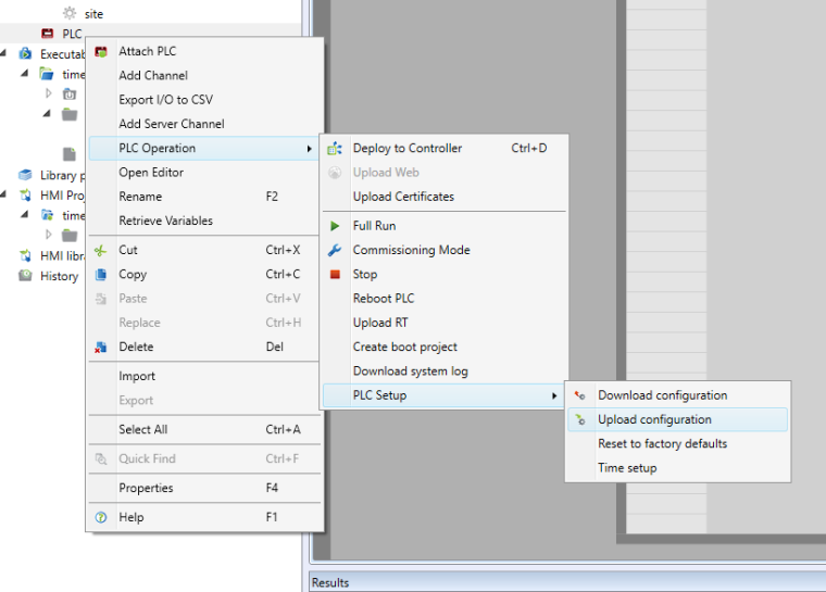

        Martin Kudláček @robl last edited by
        Hello @robl,
        the change you have made is a change of the configuration of the PLC which has to be uploaded to take affect:

          robl last edited by robl
          This seems to have worked - although when I did "download configuration" and the re-uploaded it, the timezone offset was still set to 0, it has applied it correctly this time.
            @robl The upload/download can be a bit confusing. The "Upload configuration" does set the PLC according to the settings in the solution. The "Download configuration" takes current settings stored in the PLC and copies them into the solution. Upload means "to the PLC", download means "from the PLC". In other automation software (Mitsubishi, Omron CX Programmer) is the meaning reversed.
              Yeah, what I mean is, I first downloaded the configuration, saw that the setting was already 0, and then just uploaded it again. I didn't actually change anything in between. Anyway, seems to have now got it set correctly. Thanks for the help!
