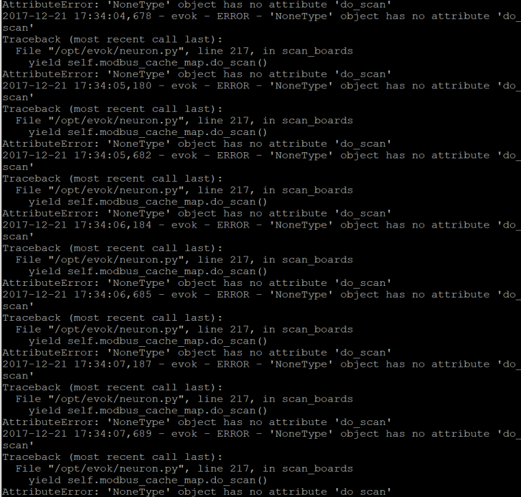

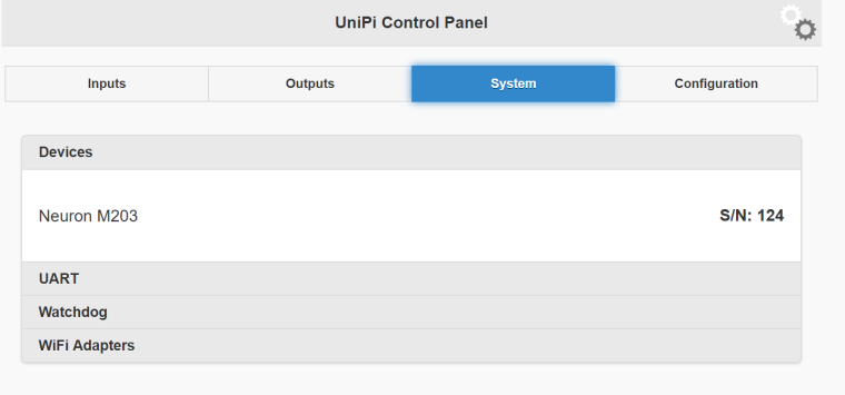

              Hello is there any solution? I have downloaded and deployed the lastest image from link UniPian-Neuron-OS-2018-02-16.img.zip. And it is not running correctly. On web page I can see only 0_1519576302837_Výstřižek.PNG
              and in error.log is
              What can I do?
                TomasKnot last edited by TomasKnot
                That looks like an unrelated error. Could you post the entire output from "ps -fax", "lsmod" and running evok manually through "systemctl stop evok" and "python /opt/evok/evok.py"?
                The error message in general appears when the linux interface cannot connect to the rest of the device. In the development branch this has been changed slightly to be better reflected in the message.
                You could also try a clean install of the latest release (02-26) and see if the issue goes away.

                  @tomas_knot If it is unrelated error, why the is no handler to print related error or at least change the error message.

                      Try taking out the power first, and plugging it back in. The device tries to flash updated firmware on the first run on UniPian.
                      I can confirm M203 behaves as this with UniPian 2-16 - on first run no devices come up with the error message you describe in the log; waiting cca a minute and then unplugging and plugging back in the device causes it to behave correctly.
                      The error message is the same because the error is principally the same - but it can have a lot of underlying causes.
