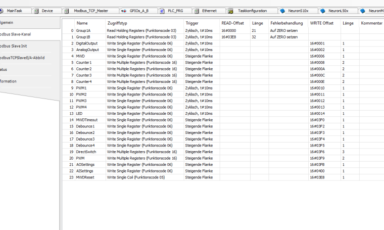

      Hey Guys,
      if've got a problem to get acces to the In and Outputs from Module 2 and 3.
      In Codesys there are only the Channels for Group 1 registerd.
      Do anyone kow, how to acces the other Groups?
      Thank You!
        DavidCozens last edited by
        Hi Yannick,
        Please look in the datasheet that can be downloaded from the CODESYS store along with the software. In there are instructions for accessing channels in groups 2 and 3. Basically you created channels as you would in a standard codesys modbus device (although all registers and coils are identified by name. You then map these into your application. There are a number of utility function blocks in the library that may be helpful.
        Group 1 is the same across all Neuron devices, so I created the drivers to automatically create channels and map the data into an automatically created function block. If users find this helpful then I could do the same for the other groups. I would be interested to hear if users find this automated mapping helpful, or if they prefer to map the channels used themselves.
        regards David
        1 Reply Last reply Reply Quote 1
        • Yannick Stein
          Yannick Stein last edited by
          Thank you very Mutch, thats what I'm looking for.
          Now if´ve got it.
