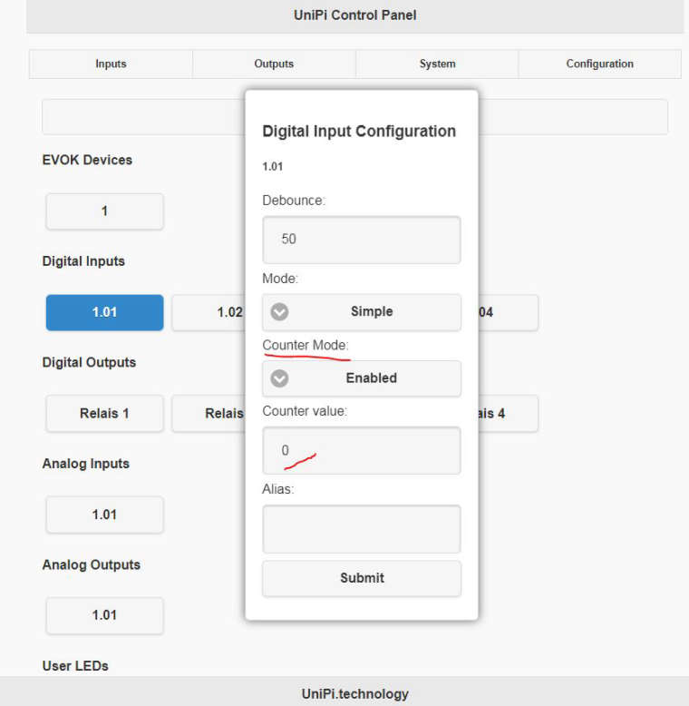

                    JoS0
                    I use the S0 like the pdf from tomas_hora and it works.
                    But the counter register is after reboot 0.

                    • Martin KudláčekM
                      Martin Kudláček @JoS0
                      Hello @jos0,
                      the counters are reset after reboot. More precisly, they are reset when the PLC loses power. They survive when the OS inside of the PLC is rebooted.

                        JoS0
                        Hello Martin,
                        thanks but I thinking that are holding register(from hold)?
                        But maybe you can help me.
                        If I save on flash the counter it`s saved.
                        To shut down I use this php comand:
                        <?PHP
                        exec("/sbin/shutdown -h now");
                        Is there an php script to include here to save before shut down?
                        Thanks for your help.
                        Jo
                        1 Reply Last reply
                        Reply Quote 0
                        • Martin KudláčekM
                          Martin Kudláček
                          Helo @jos0,
                          the name "holding register" doesn't mean the value is stored in the non-volatile memory. This is just a type of the data store which comes from the Modbus naming convention, which means it can be read and written into, as oppose to the Input register, which can be only read.
                          You can save the current value of the counter register with the saving of the current values to internal flash. This save can be initiated by e.g. setting the coil named "Save current configuration and use on startup" which has to be called on the appropriate group.
                          We do not recommend to do it very often as this will corrupt the internal memory. Try solving the problem in the program instead.
                          1 Reply Last reply
