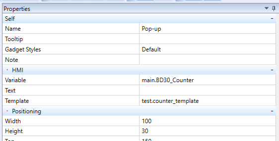

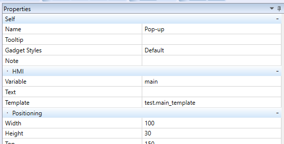

      There is no topic to do of pop-up window. I would like a smaller separate window to open from somenthing variable.
      How this gadget to use?
        AVsetula last edited by AVsetula
        Hello @L-E-F

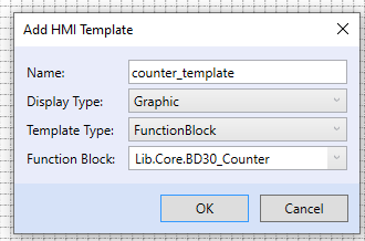

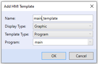

        You must create an hmi template for the function block, or for the program. Then insert "Pop-up" in the hmi template for the local web server or SCADA, where a function block, or program can be selected as a variable. Then just select the desired small template (you can have more than one ready for one block, or program).
        See the attached screenshots for examples.
