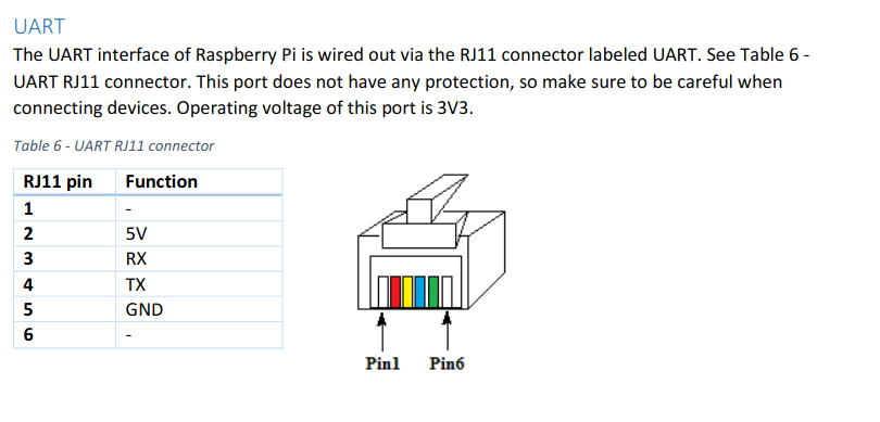

                  My question is if i need to do something to use UART connected to RJ11 on UniPi 1.1 board (the one from picture below) or it should work straight forward?
                  To which RaspberryPi's UART is RJ11 interface on UniPi connected?

                    Pins RXD0 a TXD0 (GPIO14/GPIO15, pins no. 8 and 10) -> primary UART are connected to the RJ connector.
