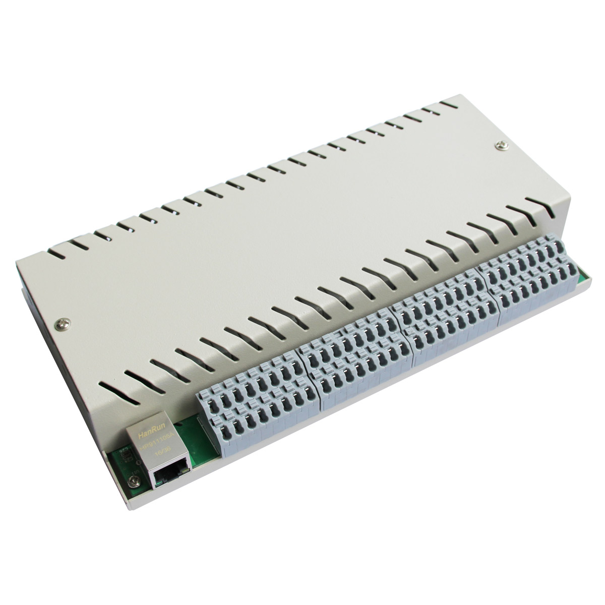

Why not go for TCP-IP solution, i use a Kincony kc868-h32, a 32 relay solution, that you can steer the relays true a url link command, works fine for me.
There are similar solutions more hobby orientated, and more pro, over Modbus, serial and TCP-IP, there are also 2/4/8/16 solutions out there, so that you can have your relays close by what you wane control, and only have to run a network or serial cable to the relay unit.
