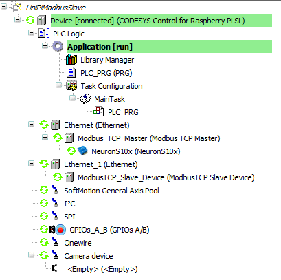

            The basic configuration looks like this
            0_1523786112750_devices.png , as you can see it is working. The firest Ethernet Device is configured to use localhost (device lo) as the UniPi Neuron for CODESYS datasheet shows.

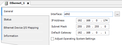

            Ethernet_1 is another device that I have bound to the cabled ethernet device like this
            On the RPi the device will be 'eth0' for the cabled ethernet. If you have connected to a specific Neuron in CODESYS then you will be able to click the ... button to select from a list of interfaces. I prefer to let the operating system specify the IP address settings, so I don't enter those.

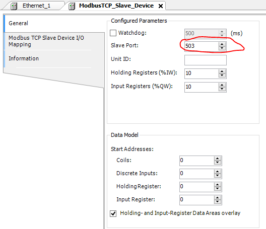

            I then added a ModbusTCP_Slave_Device - for now I have to select a different port number to make things work
            0_1523786535344_slave1.png . You can use the same screen to configure how many registers you want in your slave, the UID etc. Use the mapping tab to then map values from your PLC application into the modbus registers.
            Obviously having used a different port number your Modbus master will need to use a different port number to communicate with the device.
