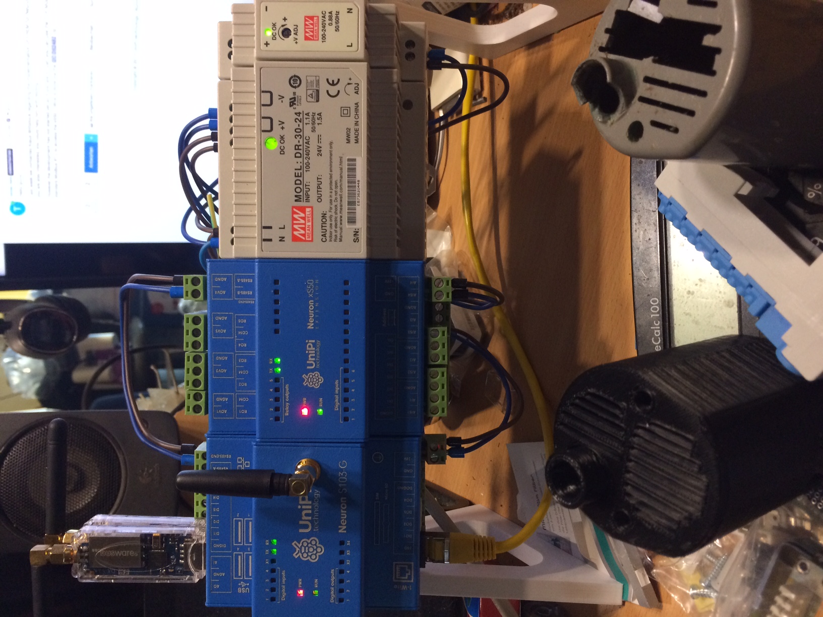

          HI
          yes thats no prob i have time and my test work is allways online
          alt text
          but hope another user use fhem and have beginn the work.
          yes the 1wire run but little scary i use 18 sensors 16 x DS18B20 and 2 from unica
          but owserver have once all sensors another second 0 sensors and another sec. and so on
          my owserverconf lokks like :
          ! server: server = 127.0.0.1:4304
          device = /dev/i2c-1
          server: i2c = /dev/i2c-1:ALL
          server: port = 4304
          but realy unstable on sensor detect.
          evok have no problem to detect all sensors only the unica is detect but no data in webui :smirk:
          Sensor DS2438 - 2620531402000075   N/A
